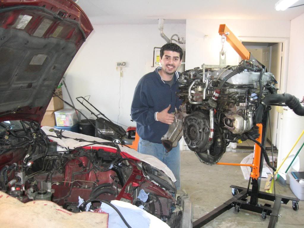

I have been working every night for two weeks to get it ready for this last weekend. My father, brother in law and long time friend came over to help with my first pull.
Said long time friend:

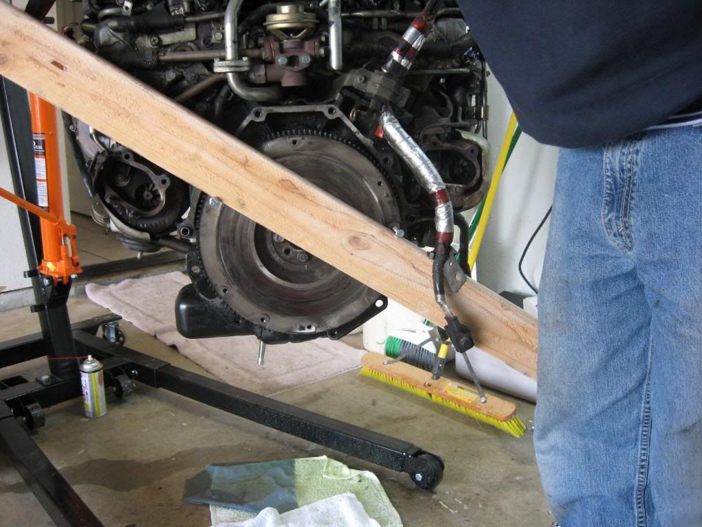

I should have broken loose the crank pulley bolt before I dropped the tranny and pulled the engine. Since I forgot we came up with this to help. Worked like a charm.

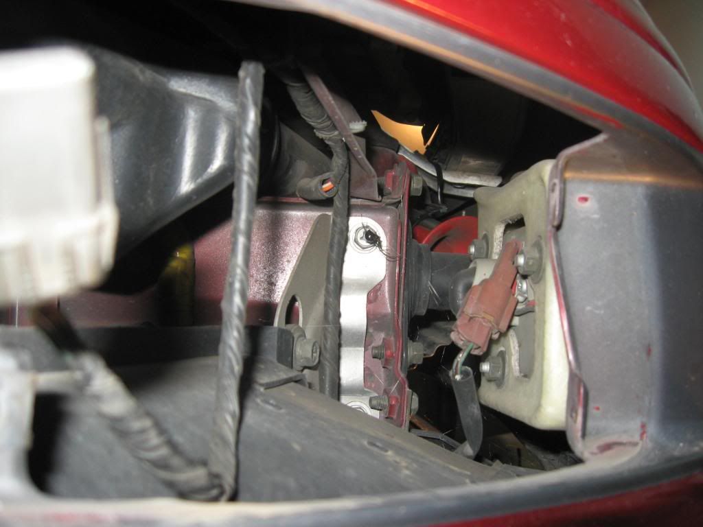

I had no idea that my engine mounts were this bad:

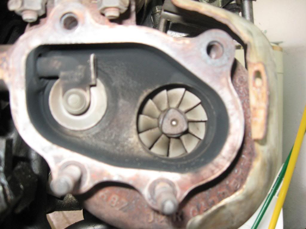

Turbo's were in much better condition then I expected. No shaft play. I will be installing new CHRA's anyways.

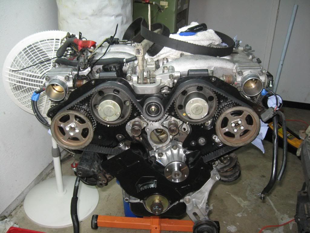

All cleaned up:
120k maintenance kit from Coz installed:

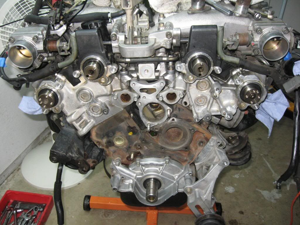

She's all done in the front side(UR Crank pulley and overdrive water pump pulley):
Driver Side first:
Progress:
Plenum comes off also...lots of cleaning to do!

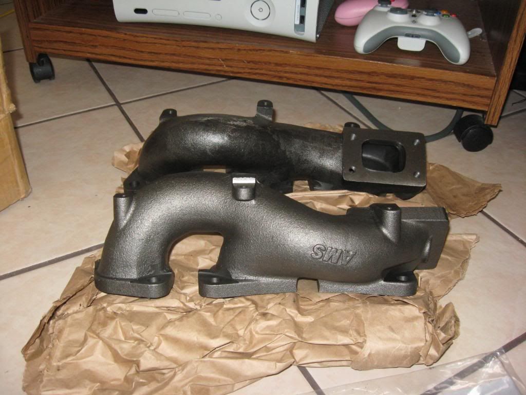

AMS mani's(as I said earlier...I'm not completely happy with this purchase but I realize you get what you pay for):

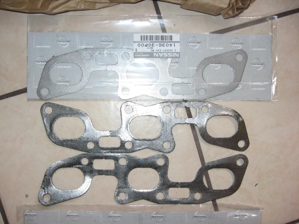

The not so nice gaskets that came with them next to OEM's.(ok, so they were not as bad as I remembered...but I will use the OEM's)

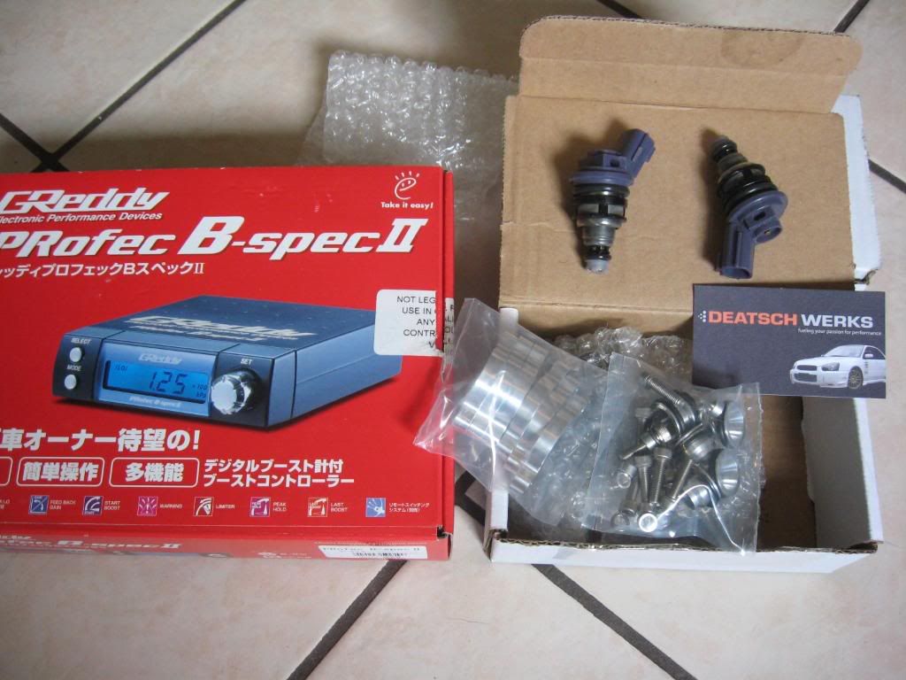

EBC and Deatsch Werks 740's and adapters:

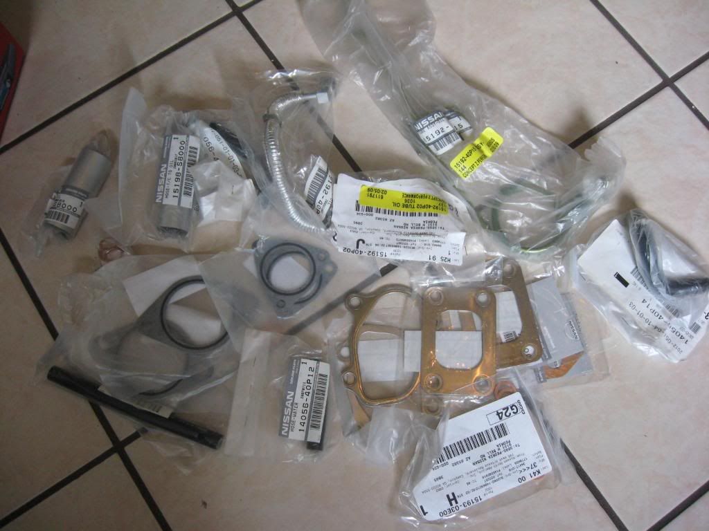

OEM turbo gasket kit:

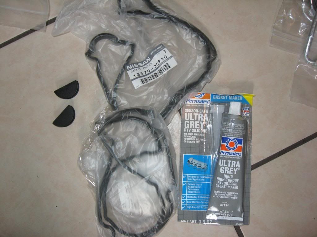

Valve cover stuff:

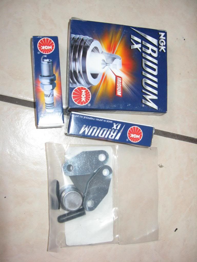

Spark plugs and EGR delete kit:

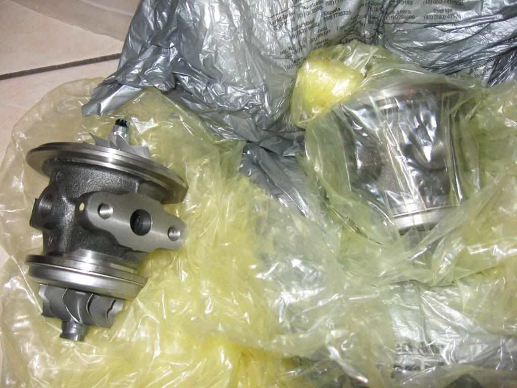

Stock chra's:
